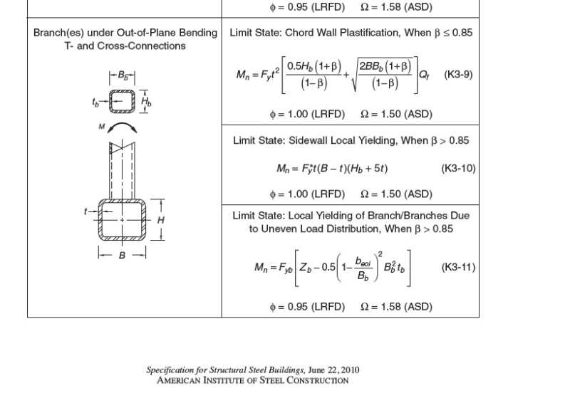

Suggest to read section "K3 HSS to HSS moment connection" in AISC 360. There may be more items needing to be checked beside the the weld, such as the supporting HSS side wall plastification (the height of the branch to chord 8/14=0.6<0.85). You also need to check the torsion capacity of the supporting HSS and its connections to its supporting members.
