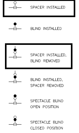

"What is a difference between spacer and Spectacle blind without blind (blind removed), "
In practice - no difference, but without some sort of context it's difficult to say.
I can only surmise that the graphic is used when comparing one state ( piping with a blind installed) to a different state where the blind is removed, but a spacer inserted in its place. or a part of a sequence of actions or actions required to move from an isolated case to a normal operational state.
the two boxes I assume you highlighted are NOT a spectacle blind, but two separate bits of metal. It looks very similar, but if you look closely, the spacer has a little line coming from it at the top, the spectacle blind doesn't....
Why do you use a spacer? So that when you want to install a blind, the gap between the flanges is there and you don't have to force pipe apart to insert it or close up the space when you remove it.

Maybe the earlier symbology indicates the there is normally a spacer (or a blind) at this location, and that either (the blind OR the spacer ring) should not be removed.
While the latter symbology indicates that a spec blind is normally at this flange.

samplanti has it right- a spacer is a disc of flange material with a hole through the middle, inserted wafer-style between flanges, similar to a flushing ring used with instruments. It may be required to provide removal clearance, or just to take up space in a line which has been shortened for some reason i.e. by replacing a long pattern valve with a short pattern valve or a flanged instrument (flowmeter etc.) of different dimension, or any number of other reasons. These are VERY common in lined piping, where it is not feasible to make a spool shorter than a certain length. Unlike a spectacle blind, it is never intended to be used to block flow. Generally a flanged spool wouldn't be referred to as a spacer. You'd only indicate the spacer on a P&ID if it serves some process function.
RE: Spacer VS Spectacle blind without blind
In my experience a spacer's function is to maintain the space required to insert a blind in order to positively isolate the line both being the same thickness normally to ASME B16.48. This would be on the P&ID whereas I would not imagine that any used as 'pup piece' would be.
