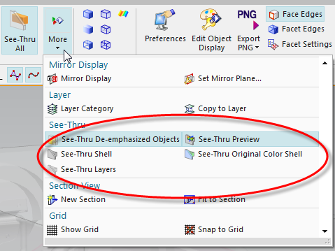

can you tell more, why, when, how ?
I assume that you know about the display state "See through all" ?
Regards,
Tomas
RE: change all parts translucency automatically
Sorry for not describing my issue clearly.
I'm looking for a journal that can change the displayed parts automatically.
just like the icon of Shaded ,the icon of Static Wireframe.
I found a journal that can change the translucency by selecting the parts one by one.
How can I modify the journal and make it to select all displayed parts automatically ,change the translucency value.

Tomas,Thanks for remind me the commad " see through-all".
I just tried it.But I found when I excuted the commad, the original colors dispeared.
I don't want it happen.
