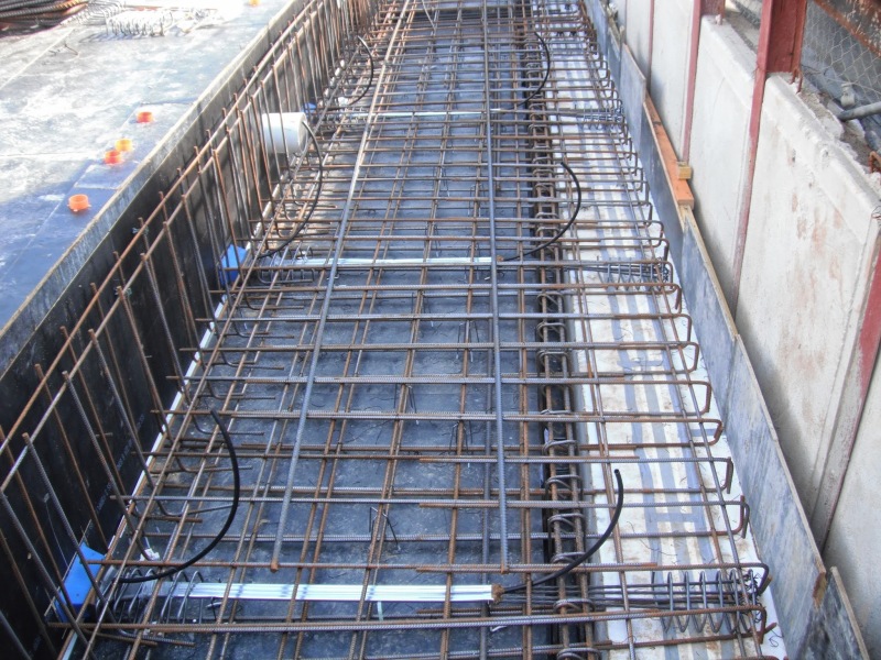

Coming more from the practical perspective, I highly recommend downloading the material available from the Post Tensioning Institute of Australia.
http://www.ptia.org.au/Downloads.aspx
In particular the 'Practical Prestress Detailing' guide. I've attached it for anyone too lazy to click the link.
