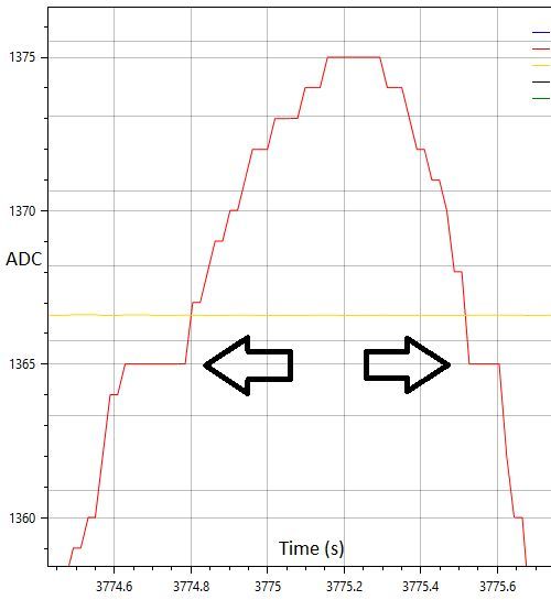

Hello,
I have an odd issue and am welcome to any ideas. My ADC seems to lag at specific values and I would like to know why, or better yet, how to fix it. Lags are shown in attached pic.
Occurrence:
Unit 1 lags at ADC value 1638.
Unit 2 lags this at ADC value 1365.
Hardware:
Analog sensor ~10mV full scale
op amp - amplifies sensor output
ADC - ADS1110 reads output of op amp
MCU - reads ADC value
PC - reads and graphs MCU data
http://files.engineering.com/getfile.aspx?folder=7...

To me this looks a lot like a calculation problem in the software the converts the ADC binary into the value on the graph.
The resolution appears to be about 0.05 units on the graph's Y scale, making the flattened peak at 3772 sec look like normal data, if it weren't for the blips in the rest of the data.
To diagnose the software, we need the ADC resolution (bit rate) the sampling rate, and the formula that generates the output value.
Knowing the types of variables (floating, double, etc.) specified in the program would be important, too.
STF

Thank you all for the help.
VE1BLL, I had a feeling it might be something like that but I think every unit would have lags at the same points if that was the case.
IRstuff, these lags do happen at other values but the values I listed are the majority. Most of the MCU processing happens at peaks and valleys shown in the graph. While the lag is happening, the MCU still saves the data at the expected time intervals. In the data file when there is a lag, there are about 5 points with the same value. '5' is not fixed though, sometimes it's 3, sometimes it's 10.
itsmoked, chemical reaction causes sensor to output analog voltage which is amplified by op amp. Op amp output is read by ADC. ADC is read by MCU with I2C. MCU is read by PC over USB in real time. PC saves data in csv and graphs it. Csv shows multiple points with same values.
RE: ADC lag at specific values
Sparweb, I changed the y-axis to show ADC values. Since the ADC values also lag I don't think the problem is in the conversion from ADC to oxygen percentage.
Attached new pic which is zoomed in on 3775s with y-axis = ADC value
Attached csv to show times and ADC values.
http://files.engineering.com/getfile.aspx?folder=9...
http://files.engineering.com/getfile.aspx?folder=f...

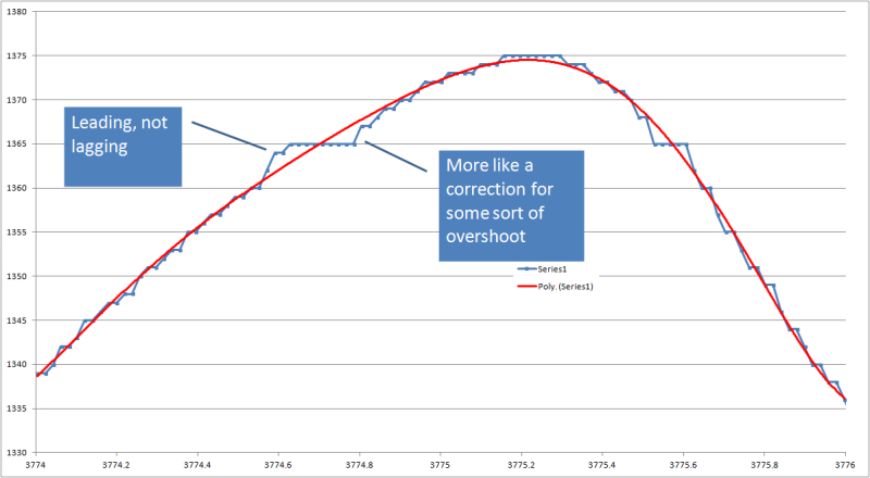

Note that the data is actually not "lagging;" it's actually leading. If the result is supposed to be a smooth curve, then the MCU output is higher than it's supposed to be, which is likely neither an ADC nor MCU problem. However, repeated output values usually is indicative of a serious latency problem in data processing; the new result isn't available, so the processor outputs the last valid data. So, it's possible that the process controller is having problems.

jimkirk, I am using ADS1110 for ADC.
I think you might be right. It does seem to be the op amp causing this.
Replaced the o2 sensor with a capacitor and charged it slowly to test different parts of the circuit today.
Replaced MCU with Arduino.
Added 2nd ADC to measure same net as ADS1110 (original ADC).
ADC1: ADS1110 being read by Arduino I2C.
ADC2: Arduino ADC
Signal: Voltage across cap. Voltage increases slowly over time.
Test 1:
Signal location: ADC input
Result: no flat spots in either ADC
Test 2:
Signal location: op amp input
Result: same flat spots in both ADCs
Result shown here:
http://files.engineering.com/getfile.aspx?folder=8...
Note: op amp output is connected to ADC input.
Conclusion: I think the op amp is causing the problem. Now to figure out how to solve the problem...
I listed the ADC by accident when the op amp part# was requested.
This is the op amp:
OPA330
http://www.digikey.ca/product-detail/en/OPA330AIDB...
Another thing to add is that the lag time is related to the rate of change of the signal. If the signal is changing quickly the lag doesn't last long, if it changes slowly, the lag lasts a while. Got the lag over 10 seconds with a signal that was changing very slowly.
I took some ohms out the resistor between the op amp output and the ADC input and that seems to have sorted it out. Thanks again for the help everyone.
