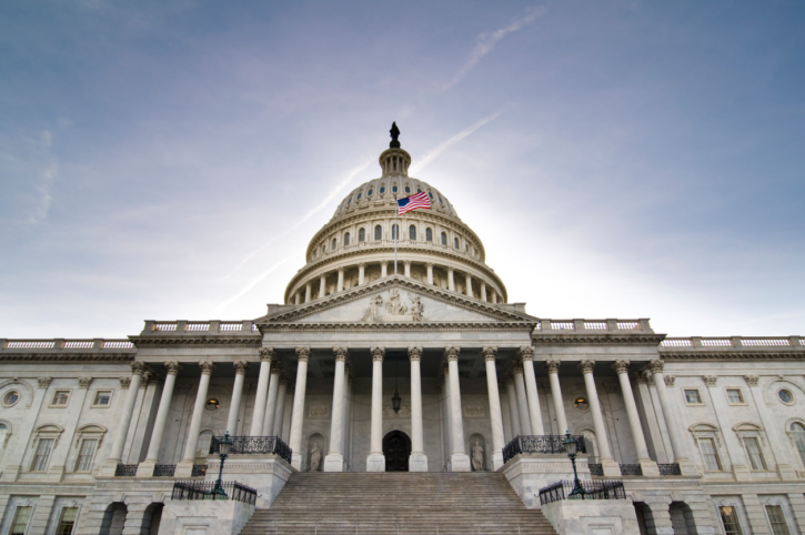

Perhaps OSHA should make a visit to the site below:
RE: Handrail for Exterior Stairs - USA code question
Congress can exempt itself from the law and they call the Mafia organized crime.machinegun
