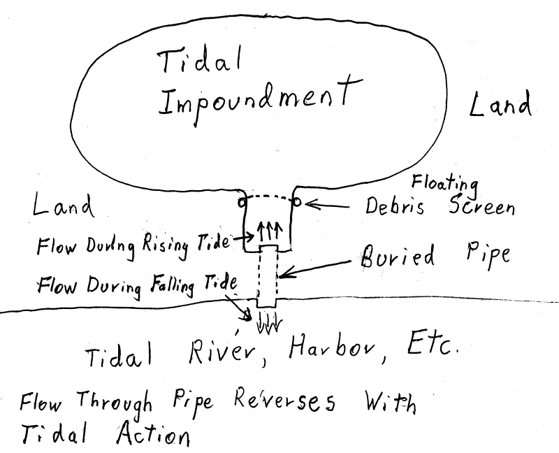

I don't know the OP's application, but he does mention "changing tides". I know of an installation where the layout he describes is reasonable - the inlet/outlet of a tidal impoundment. My sketch is shown below. The pipe is totally underwater most of the time. For this application, especially if it is in an urban environment (say a coastal city park) the debris screen would likely collect only light debris. The screen is somewhat self-cleaning with reversing tidal flow. Normally, flow trough the pipe is fairly slow. For the real installation I know of, flow is very fast during tidal extremes (king tides). The floating screens the OP linked to are only 2', 3' or 4' high - water can go under the screen.

SRE - that looks quite reasonable but a 66" storwater pipe at 10ft/sec sounds like a lot more water flow in one direction to me...
Anyway I got about 2 tonnes force on direct flat plate, so maybe not a huge force for "a 12" square precast prestressed concrete pile embedded 20 ft or so into the soil, and sticking out 13 feet or so above grade "
Sounds quite strong to me.

LittleInch - You are right about the high flow capacity of the 66" pipe. The impoundment I know of (a city park lake) covers 10 acres. A few times a year, there may be a 6 ft. tide rise/fall in say 6 hours. So, an average of 10 acre-feet per hour of water through a 66" pipe (I don't know the size of the exiting inlet/outlet). For those conditions I get a flow rate of 5.1 fps. Briefly, at peak tidal flow during the 6 hours may be 7 fps. During a hurricane storm surge, the water rise would be much faster... but probably not designed for that.
Depending on how much "sag" (mainly horizontal, but some vertical at low tide) there is in the cable holding the floating screen, the pull on the piling could be a good bit more than the two tonnes on a flat plate.
