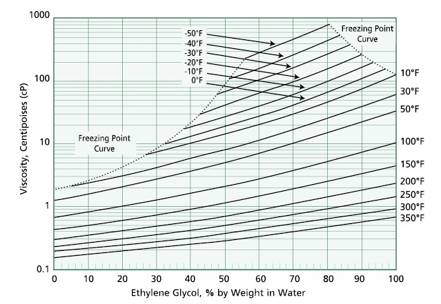

I'd say yes. Just make sure you are always in turbulent flow regime and keep MEG at reasonably high temperatures to avoid flow problems at increased viscosity. There is a threshold value above which the pump will not be able to deliver the required flow, unless the entire system is designed for cold start.

Temperature at piping inlet is ariund 60c and hysys predicts temperature decrease to 31c along pipeline in worst case.Meg is 70%wt and viscosity is around 5.8 cp @31c.also reynold would be 17000 at this condition.however it seams than we should be careful in defining turn down ratio for pipe line.
Therfore according to your chart there would not be any problem.what is your idea?
Would you please let me know reference of your diagram?

Viscosity chart is taken from MEGlobal
I don't know what economics and design criteria you used to prove that 3km 6" pipeline is cheaper and better option than 4" pipeline and a shipper pump.

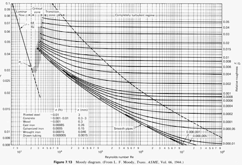

With Reynolds 17,000 you are actually in the transition zone, not in fully developed turbulent flow regime - and you are there for the design (max flow case). Something's wrong there.

Actually i am still worriey a little bit about reynolds number.For 6inch pipe depending on temperature ,reynolds would be between 17000 upto 38000.for 4inch pipe in best condition reynolds would be 58000.for both cases we are not in fully developed regime.velocity for 4inch is 1.33m/s and for 6inch is 0.60m/s.

Dejan,
I think for pipe fully developed turbulent flow is normally once you go past Re of 4000.
Fully developed flow into an open end of a pipe occurs within 40 D.
That line on the chart is misleading for pipe flow. The flow at 4 and 6 inch is fully turbulent IMHO.
