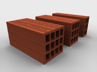

i got the information just now from site that the only available blocks there is burnt clay hollow blocks unfortunately as shown below.
so now i am again confused how i can make the dowel connection as yo suggested above ????
RE: Hollow Block Wall Lateral Support
The top face of the clay block can be sawn off horizontally, and the top of the block used as a bond beam, with rebar laid into the cores, and grouted in. Do this for each bond beam course.
