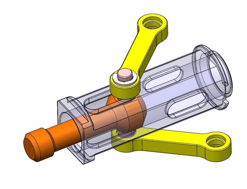

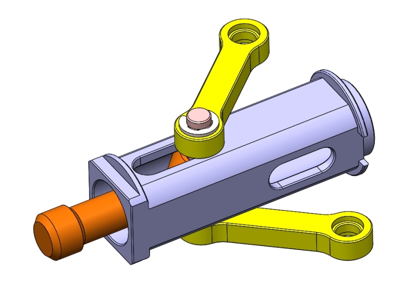

Actually, I can show some screenshots, the length of the link is about 12 mm.
Do you think it's a good idea to make the orange piston from C86300 bronze and the rest of the parts from 17-4 PH?
RE: 17-4 PH vs 420 Stainless Steel
If the plunger is bronze will it be strong enough?
I take it that the links (yellow) will bear directly on the pin (pink?).
If so I would consider making the links in 420 and the pin in 17-4PH.
You could temper the 420 at 1000F and age the 17-4 at 1050F, this would put both of them at about 150ksi UTS (35-40 HRC). If you need more toughness you should higher temps (and lower strengths).

And what alloy would you choose for the "cylinder" (the transparent part) and the "piston" (the orange one)?
One of the most significant factors in this design is the cost, any dollar we can strip off the production costs is important.
How tight is the fit in the cylinder?
If someone expects this to sit for a decade and then activate without a fault then cost does not really matter to them.
How big is this thing? Can you hold it in the palm of your hand?
How much structural load is there on the cylinder?
