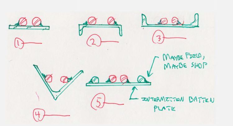

I've got most of Fisher's stuff and I can't say that I've seen anything on this in particular. The connections are certainly a problem. Should you need to reinforce the bottom chord, the sketch below shows the options that I'e encountered. The right one depends on:
1) The skill and preferences of the welding team.
2) How much capacity you need.
3) How concerned you are about the impact of shifting the bottom chord centroid.
4) Available headroom.
5) Services below, above, or attached to the bottom chord.
6) Potential interference with bridging.
7) Material quantities not at all.

Thanks for the sketches KootK. Hopefully I can keep the reinforcement limited to the web, but if not those are all good suggestions.

You're welcome. You might wonder why I bothered to include sketch #4. At first blush, it would seem to be the most obtrusive and inelegant of the bunch besides the nice centroid alignment. You may want to do #4 even if the bottom chord does not ostensibly require reinforcement. Here's why:
1) Geometry will likely conspire such that your connection reinforcement will introduce eccentricities into the joint.
2) The eccentricities will create a tendency for joint rotation that will be difficult to counter because none of the members coming into the joint possess any real flexural stiffness (all rods).
3) The angle increases flexural stiffness considerably and rectifies the joint. Or so we hope.

Yes, I think the connection eccentricity might be the tricky thing here. If I use rod web reinforcing to keep it within the web space to simplify connections, the simplest solution would seem to be to add the reinforcing rod "under" the webs and weld to chords directly. This would tend to lower the workpoint (which is probably already lower than the centroid of the chords due to the bend radius of the continuous chord).
I will have to put some thought into this if the job comes through. For the one case that I ran through quickly, only the end 6'or 8' of the joist web will need reinf. and the chords are OK as is. I would hate to add a full 32' chord angle just to combat connection eccentricity, but it might come to that.

That's what I was envisioning too. If the job comes through, check back in and we'll see if we can't dream up some manner of concentric reinforcement.
Quote (RWW0002)
Well, if you're only adding the chord reinforcing to deal with the joint eccentricity, then there would be no need to go full length. Basically just in from the ends up to the last joint requiring reinforcement.
