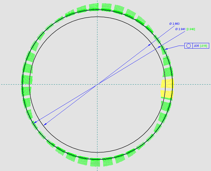

So Im trying to understand circularity and I thought I had a grasp on it until I see how some of my parts are measuring up in this metrology software. The picture shows a ring with a certain diameter and the only tolerance on there is the .035 circularity tolerance. The reading shows up at .016. The software is setup to show yellow lines when the tolerance is 75% or over. So the reading of .016 isnt even half of the tolerance. The reading at the point of yellow is about .010 off nominal. Does anyone understand how this could be showing up as yellow?

You have deviations on both sides of the perfect circle. So you can only have +/-.0175 deviation. -.016 is more than 75% of that.

The dimensions indicate the circles represent the size limits and NOT the circularity tolerance. I assume the green and yellow "bars" represent the radial distance of the surface relative to an axis of rotation (center of the inspection device). You did not provide the "thickness" of the part, so I assume it is "thin" -a disc and not a pin.
First: Rule #1 is in effect here, so the surface can never be outside the boundary of a perfect form at MMC - a circle of 2.941. Many of the green bars extend beyond the 2.941 circle, which represents the perfect boundary, so Rule #1 is violated and the size is too large and also out of tolerance.
Second: The .035 circularity tolerance reduces the default 2.941-2.663 = .278 circularity error allowed by Rule #1 to two coaxial circles .035 radially separated. These circles "float" inside the boundary of a perfect form circle of 2.941 and get larger or smaller as the size varies. Again, I assume the two circles you show are size limits and not the .035 form error circles, which would be much "smaller" at the magnification shown.

Let me clarify something that I did not before. The part I am measuring is a ring, it has an Outer Diameter and an Inner Diameter. I am only showing the measurement of the outer diameter of 2.941 and not the inner diameter of 2.663 both of which are nominal dimensions. I probably should have deleted the inner diameter from the test to not confuse anybody. Sorry >.<
Isnt the .016 measurement a combination of the high side and the low side? In this case, the circle is off perfect +.006 and -.010 which I can see makes the .016 reading. This software would change the actual reading dimension to show up yellow also if it was getting out of tolerance. So the .016 would show up in yellow as well as the area that is getting out of tolerance. I tested when the reading shows as a fail and it fails when the Circularity is toleranced at .028 but passes when its at .029 so I dont see how the .016 reading Im getting follows that reasoning because then it would fail once it got lower than .032.

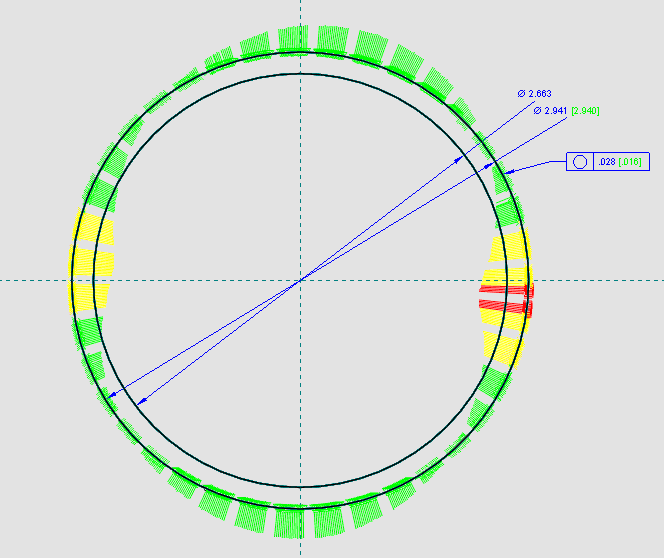

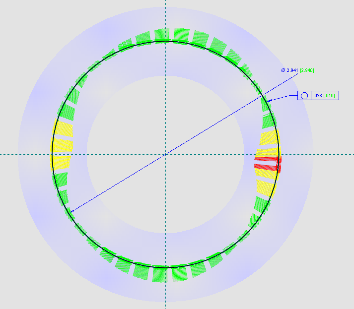

Here is the same example as above without the ID and with the boundary limits shown set by the .028 Circularity tolerance I altered it to.
RE: Circularity on Metrology Software Question
I am confused.
What is the ".016 reading"?
What is the blue annular "ring"?
Why did the .035 change to .028?

The .016 is the results of the measured data, its the circularity reading.
The blue ring is the tolerance limits set by .028 circularity test. So +/- .014 on each side of that test.
The the .035 changed because I wanted to find out when the software resulted in a fail. So .028 is when this data first failed.
What I am confused about is that I thought the data would fail once the measured data went beyond the blue tolerance boundaries. But its failing before that point so Im trying to find out if theres something about circularity that Im not understanding. The measured data is only .010 max off nominal on any side.

How can the software give circularity error reading = .016, yet in the same report that this number fails circularity tolerance of .028?

The circularity error is not a +/- value from a nominal value. I think that's why it's failing as soon as you reach .014 from nominal. The error is the distance between the farthest out and farthest in point, unassociated with a dimension.

I agree with powerhound and with these clarifications. First: The axis of actual form error circles MUST be coaxial - on the same axis. The outer,largest circle of the actual error passes through the outer point (that is farthest from the common axis of the circles) and inner smallest circle passes through the inner point. Additionally, the distance between the two circles is the actual Circularity error. Second: This is a radial deviation so the actual local size (diameter) can be up to twice the form error.

Second: those unfamiliar with circularity control assume you can use a mic-check to inspect circularity error. Diametrical error equals form error - not the case. The diameter (size)can vary twice the specified form tolerance and still have acceptable form error.
