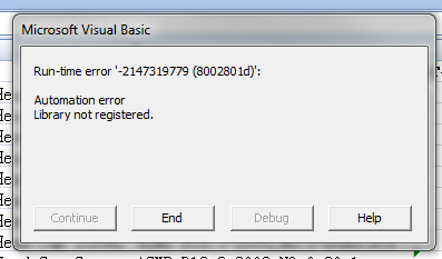

Ok, I see it. I hit Update Parts, but then I get a Runtime Error.
We still use Excel 2007 (yes, we still live in the dark ages mad
Does this have something to do with the error?
