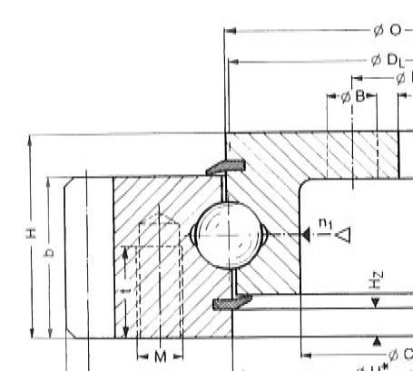

Hello,
if you have a slew bearing alike this one:
DON'T press. There's a plug or sthg somewhere where you can open up & get the balls out of the raceway. However, "jammed" might mean that the bearing is seriously damaged (broken ball, deadlock from debris) and the opening will not be possible by normal means. In general such maintenance should be left to a specialized company.. which might also be able to provide a replacement, just in case.

Hello Rol,
that's really helpful. we found a small pin for the ball bearing doorway on inner side. now still thingking how to take out the doorway. we managed to take out the pin already.
by the way, do you know what is the name for the top and bottom seals?

it seems that it doesn't have upper seals though. I think it's probably a write-off, if you haven't removed them yourself just prior to taking the picture.
