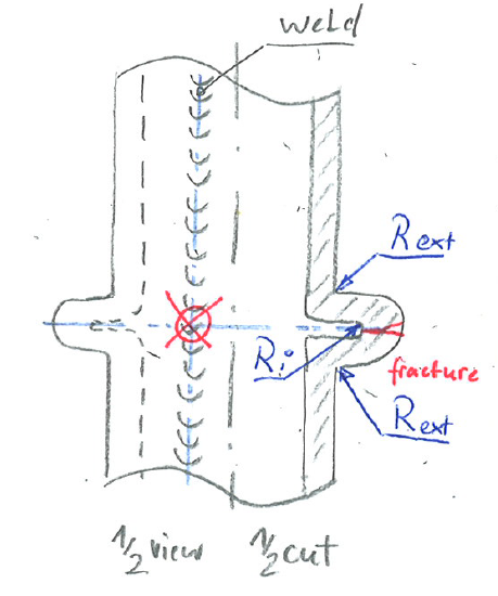

Fully agree with metengr.
To achieve external and internal collar radii that small in the forming process the pipes had surely to be heated (they're blued due to this, correct?), and clamped very strongly. I'd presume a manacle like device with a kind of spikes on the inside to bite into the pipe material. But even so, perhaps, the pipe slips a bit during application of forming force, thus the "hammering marks" on the non-finished side near to the bend.
But however clamped or not or hammered or not, I'd assume rather important forming forces being applied. Now, you name welded pipes. This makes an elongated imperfection in longitudinal direction, overlaid with a strongly deformed zone across the section. So, lots of possible root causes (deformation vs. wall thickness + forming temperature appropriate to material, local weld imperfection, hardened region around weld vs. required formability) but if looking for the start of the fracture i'd look here:
imo the crack was there before pressure was applied, the manufacturing process (& of course QC procedure winky smile is to be reviewed.
