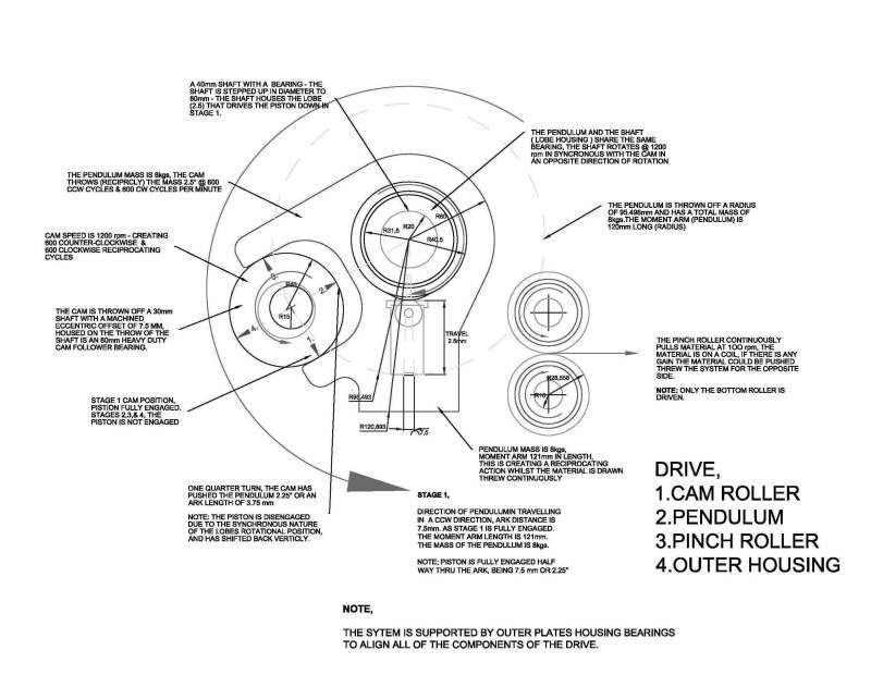

Hi, I was hoping someone could help me calculate the size of a drive to run the following,
1. a pinch roller pulling a wire total force 50n, roller radius is 28.559, 100 rpm
2. a lobe (cam roller bearing) swung off a shaft pushing a piston arrangement down, needing 100kg of force perpendicular to the shaft, shaft being 80mm diameter - with the lobe protruding 2.5 mm (42.5mm radius), the piston has a roller contact the lobe. the shaft is turning at 1200 rpm.
3. a cam spinning at 1200 rpm - throwing a pendulum anti & clockwise 2.5 degrees, ark length only 7.5mm - so 1200 is really 600 cycle clockwise and 600 cycles anticlockwise. the pendulums mass is about 8kgs, with a 120mm moment arm, some weight is around the bearing housing and some situate around the cam mouth which is on the same swing radius of approx 100 mm. the cam is set into a birds mouth arrangement.
I calculated that I would require 4 to 5 kilowatts approximately. i would use double sided timing belts to drive all axis from one motor with a servo drive
your help would stop many sleepless hours. if you can make sense of my question.
many thank s Michael

Sounds like reciprocating masses so acc's en dec's hence fluctuating moments and power.
Please post a skeleton sketch where masses and work distances be seen.
So a moment curve per motorshaft rev can be figured out.

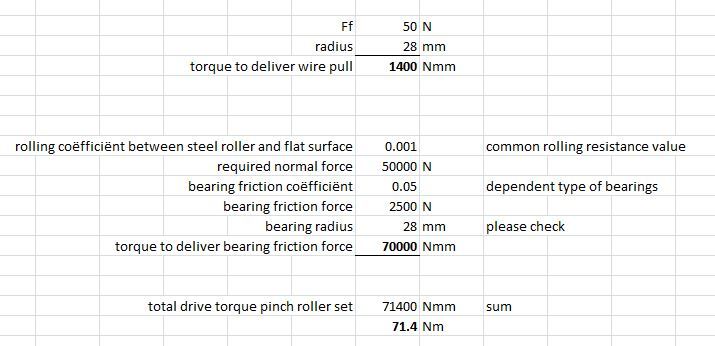

Hi Michael,
Let's start with the pinch roller set. Is the 50N the pull force in the wire?
RE: sizing a AC (drive) motor for a system that requires 3 separate outputs
The force to drive the pinch set can be much higher because of bearing friction. See figures in this example calc.
Hi Micheal,
I can't read the text. Can you please upload the picture as an attachment instead of clipping into the post?
Thanks, it is clear now. I will look into it and get back to you.

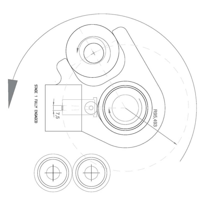

Hi Michael,
Just a few points to clarify if I understood this correctly:
A. pendulum arc travel distance at 95,5 mm radius is equal to the eccentric cam offset is equal to 7,5 mm
B. 7,5 mm arc at radius 95,5 mm is a pendulum swivel angle of 4,5 degrees
C. cam is rotating 1200 rpm, so there are 1200 clockwise and 1200 ccw swivel movements of the pendulum per minute
D. 1 cam rotation takes 0.05 seconds, so a clockwise pendulum movement of 4,5 degrees takes 0.025 secs and the ccw movement of 4.5 degrees takes another 0.025 sec being total 0.05 secs
Are you OK with these observations sofar?
Regards,
J
Hi J,
thanks for showing some interest in this contraption.
A. correct
B. correct
C. yes correct
D. again correct
All is observed correctly j.
Hi Mike,
In the attached pdf you can see what I found to be the torque and power curves to drive the eccenter shaft for generating the pendulum swivel motion only.
Is this in your area of expectation?
This is another part of the total torque and power sum you're after.
J
Hi Mike,
Finally I arrive at a 4,9 kW 1200 rpm motor. It appears that the cutting force 100 kgf of the rocker driven by the lobe shaft is by far the main power consumer. I added a 1,5 operation factor (for losses by friction etcetera).
See attached zip file.
