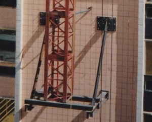

General and specific question about reviewing a loads imposed submittal for attachment to a building that you've designed:
- Does the responsibility of the designer for the equipment/system that is loading your structure include the anchorage/anchors? What if the failure is a pullout from your slab/building?
- Specific situation that is making me question this: I have a submittal for a dunlop mastclimber, essentially a small hoist system for installing facade. In order to install this over a neighboring building the designer is using outriggers which support a platform that the hoist is supported on. This will be a 20 story system sitting on the platform. For outriggers they are using double angle hangers that get expansion bolted into our concrete columns and shearwalls. Their calcs are good, including pattern live loads and wind etc. and all applicable spacing and edge distance factors - but their anchors are calc'ing out to in the 0.95 to 1.01 range which they are calling ok. I'm not so brave and if it was me supporting a 20 story hoist I would not trust expansion anchors to that level of confidence. I spoke to the designer and he seems very competent but I suggested using collars around the columns and through bolts through the wall, he said that they do these all over the county and this is what they always do. He said that he can add 2 more anchors if it makes me feel better but it's not necessary. I've reviewed the base building (cols and walls) and there is no issue with the loads imposed. Do I have any responsibility for the capacity of the anchors?
RE: Review for Loads Imposed Responsibility
I think that you're in the clear here, as much as you can ever be. The anchors can't be properly specified without considering the concrete failure modes. Of course, slab moment and shear matter too so it's a bit blurry as to where their responsibility ends and yours begins. If you have records on file that show that that the designer did the anchorage checks, I'd be comfortable with that.
There's a picture on the mastclimber website that shows basically the same setup, scroll all the way down 'cantilever bracket'. The current design shows 8 anchors for the top connection (the diagonal hanger).
http://www.dunlopmastclimbers.com/accessories/

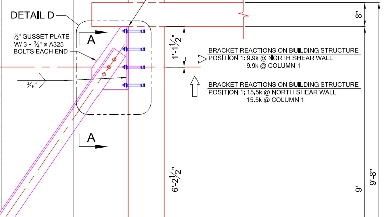

When we spoke on the phone the add'l anchors were discussed but I didn't note it on the submittal or in writing for fear of implicitly blessing the anchor design. The current design is noted to avoid hitting rebar and that the actual layout will be re-checked by the designer.
I haven't reviewed one of these before and I'm surprised that they aren't more conservative based on the relative risk compared to the cost of putting a collar around the columns or some other more robust system.

Thanks for all the opinions, looks like my squeamishness is warranted.
The photo that kootk posted is correct, essentially the same setup except that on mine the anchor plate is flush to the concrete (that photo appears to show it over some type of facade). This is over an adjacent 1 story building and ours is 22 stories, so this will be 20 stories tall, >200ft. On our situation they are using two rows of 4 anchors (8 total) so if they add more anchors it would have to be by extending those rows and hopefully enlarging the gusset plate connection.
I have not asked them to change the design for essentially the reasons calvinandhobbes listed - I spoke to the guy and he seems competent, his calcs were thorough (I checked them and also ran the anchors in profis for a double check), and at the end of the day it's his design and it works on paper.
As far as qc - they are asking for pull testing of 25% of the anchors, the conc is spec'd at 7ksi and they've assumed 6ksi but almost all the breaks are coming back at 9+, I sent a separate email to the CM asking them to watch over this with special attention (although as c&h said the likelihood of that happening is small). I may ask them to get a hilti rep on site as well.
I'm all for designing to 0.99 but this one seems different. I'm not usually a wimp on site but I wouldn't go up on this thing. I hadn't thought about the tiebacks but you're right, if nothing else they'd probably give this thing a chance at hanging on and not totally going south - would hate to test out that hypothesis though.
Here's their detail for the hanger. They also provide an elevation of the plate showing anchor layout and another detail showing bolt layout in the angles.
