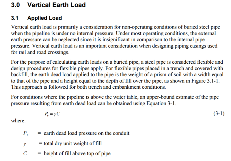

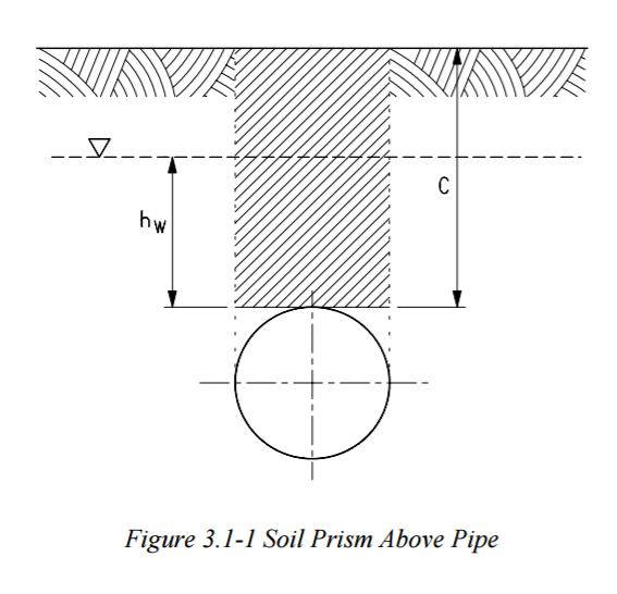

From ASCE/FEMA document entitled "Guideline for the Design of Buried Steel Pipe" dated July 2001:
RE: LOAD ON BURIED PIPE HUNG FROM STRUCTURAL SLAB
Thank you Ingenuity. My thinking had been that if the hangers for the pipe corroded away and the pipe dropped down, then the granular soil would start running into the void left by the pipe where it had dropped down, and the soil would continue running into that void until the angle of slope of the soil each side of the pipe equaled the angle of repose of the soil. From that I thought that the pipe should be designed for the weight of the soil that would have run down if the pipe dropped down. It seems that my thinking was not correct, based on what you and MotorCity have told me. Thanks again.
