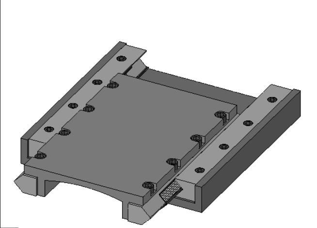

Hello,
gyros is greek winky smile and means circle, so a gyroscopic effect (self stabilization) is based on the rotation of a material body where the COG is located suitably. However, this needs a drive to impart the rotation.
From the spin of your post however i'd rather conclude you don't want to push a rotating object, but to prevent the movement of that frame into certain directions whereas being able to move it in others. So, a guide track or rail guiding might be a step towards your intent.
Do you have any mechanical engineering handbooks / some qualified mechanical engineer / technical college o.e. close at hand?
And a sketch would be a very nice first step towards a better understanding of your idea..
