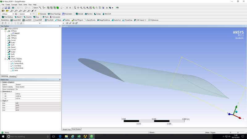

How to find Ixx and Iyy of this blade in ANSYS

You should transfer your geometry to structural analysis module. Open the mechanical setup of Ansys workbench static structural module, click on the entity information 'i' tab. select the interested body and you will get moment of inertia's and other important information as well.
