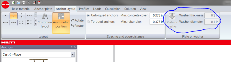

Has anyone ever been able to click on the Plate or Washer in Hilti Profis? I've never been able to do it, and am wondering what the trick is if it's even possible yet. Might just be a software error.
RE: Add Plate or Washer in Hilti Profis
I believe you must have ACI 318-11 or 318-14 selected in order to use that feature.
Perfect, thanks!
