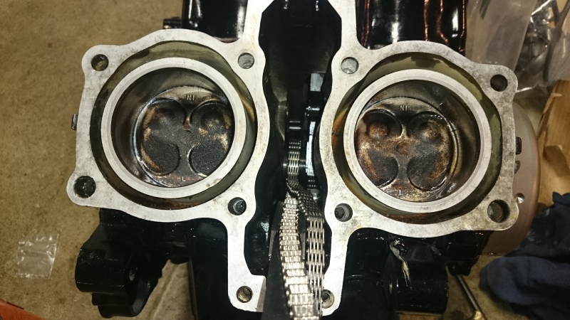

Same scenario, but with an 800cc V4 motorcycle engine rather than the 400 in the original. Open deck cylinders.
I've already concluded that wet liners with a flange are the way to go & can source these from other models along with pistons etc, so thew only mods I would need to make would be custom modified head gaskets.

Hi Jack, Honda did this with the VF1000R motor & the plan would be to copy that method.
Bore out the old MMC liner, machine the base such that a stepped press fit to seat the bottom of the new wet liner with one or two O-rings to seal the crankcase from coolant contamination. The flange on the liner top will be skimmed to level everything & that will be the sealing face to the head. The liner will be supported over 2/3rds of it length in the crankcase, with only the top third as an open deck.
The liners I have in mind have 75mm bore (stock is 72) & may get bored to 76mm. That will leave 3mm wall thickness for a total diameter of 82mm. Current alloy cylinders are 88mm diameter OD, so the coolant capacity of the block will increase a bit which will be a small benefit & should help compensate for the reduced thermal conductivity of the iron wet liners.

The wall thickness is 8mm as stock, but the MMC liner is castleated & 2.5mm wall thickness & due to casting movement from a block I cut up, it needs to be bored out to 78mm to clear the MMC fully. That would leave 5mm wall thickness, so possibly enough, possibly not.
