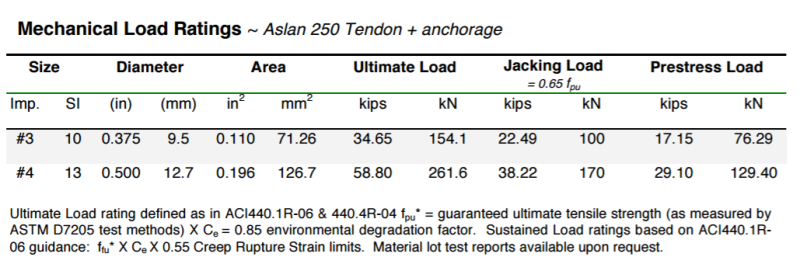

Hi everyone, I am looking for CFRP tendons for my research.
If anyone knows where to buy this type of materials, please let me know.
I did contact with AslanFRP as suggested by Ingenuity. Unfortunately, they did not supplied FRP tendons anymore.
I was also searching on DFI website but no CFRP tendons were found.
@Hemi79: Had you bought CFRP tendons then? if so, please help me on this.
Thank you all,

I was speaking with HUGHES BROS recently (this week), and they do still manufacture #3 and #4 CFRP bar tendons and are readily available, but maximum of 40 ft lengths. They no longer sell in 250' coils due to safety reasons of unpackaging.
Contact doug@hughesbros.com and he may be able to hook you up with an order or supplier/distributor in your area.
