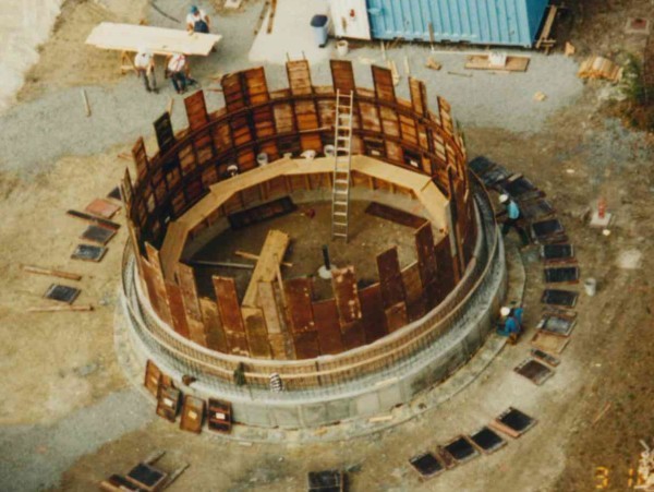

What the OP is describing is a vertical open, cast-in-place caisson. Here is a photo of one in the early stage of construction for an extensive storm water drainage project in Charleston, SC (high water table, high seismic, poor soils)
The cylinder is constructed in lifts, at the ground surface. When a lift is complete, the cylinder's center is excavated allowing a the cylinder to descend a controlled distance under its own weight. The wall thickness is calculated to provide the proper weight to penetrate the upper soils but stop when a firmer layer is encountered. Note that the OP's soil at 40 meters is better than the overburden. Cylinder decent can even be controlled to keep the cylinder plumb by carefully managing exactly how interior excavation is performed.
Here is a brief summary of the Charleston project:
Storm Water Shaft Construction
www.SlideRuleEra.net idea
www.VacuumTubeEra.net r2d2

That is one way, SRE, but I wouldn't call that a diaphragm wall. I think the OP means a slurry diaphragm wall, commonly constructed by displacing bentonite in a trench.
RE: Lateral Earth Pressures on a Deep Rigid Shaft
Hokie - Rereading the OP's question, I see you are probably right. Odd that he refers to an "internal pre-cast concrete liner". I was thinking of a "liner" to an outer (concrete) casing.

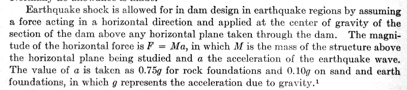

JSco25 - I read the Wood and Elms paper carefully. It appears to address seismic force on a linear wall. Have to wonder if that approach accurately models a rigid cylinder.
I hope what I say next won't get me booted out of this forum hammer.
As a rough check, perhaps the cylinder could be considered to be a rigid body with the seismic force addressed the old way, as on a dam... in 1934:
"Civil Engineering Handbook", page 806, L. C. Urquhart, 1934
The value for acceleration used is based on modern references for the project site.

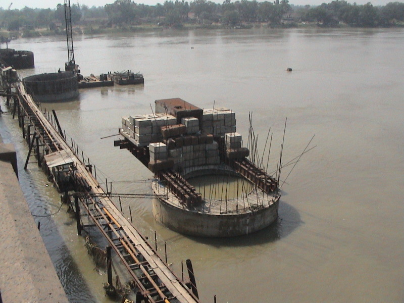

This seems petty complicated . . . I like miningman's thoughts on ground freezing. I know that it has been used many times. SRE actually shows the installation of what they, in India, call well foundations. It seems to me that this might be a better choice than a diaphragm wall, then digging out inside, etc., installing a 28 m liner and then backfiling in between - however as the picture shows there are "dangers" to this although it is used extensively in India.
You might find NN Som and CS Das' book Theory and Practice of Foundation Design, Chap 10 of interest. It explains earth pressures on large diameter "wells" in the ground.
