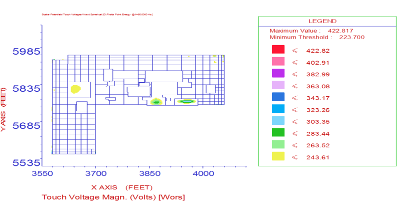

Guys,
I have 26 KA ground fault to be taken care by ground grid. I have put so much copper and rods but it doesn't change that much. Should I put ground well or anything else?
Any help would be appreciated,

Just put few conductors in the middle of regions/squares/zones with high touch voltages.
Usually, major touch voltages appear around corners and outer regions (fringe effect)
RE: CDEGS
True, but I have a concrete foundation in those area.
May be I should put more rods around those areas.

You should consider expanding your grounding grid outside of your substation if you can. The L shape of your grounding grid is going to force you to use a lot of copper conductor to bring down the step and touch potentials around the edges and corners. I have worked on a substation that had a section that were fenced off from personal due to the odd shape of the substation and whoever not wanting to spend money on a robust grounding grid.

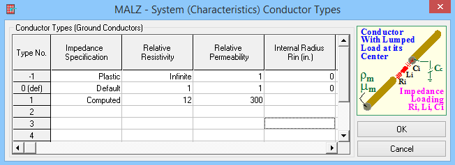

Thank you all for very informative post. I want to share the CDEGS help desk email in this regard too,
Quote (CDEGS)
The concrete foundations reinforcement bars are generally connected to the grounding grid and may improve the grounding performance of the grid. The concrete itself, being a very hygroscopic material, tends to attract moisture from the neighboring soil and will eventually acquire to same resistivity as the soil it is in contact with. Consequently, you often can model the rebar only, and omit the concrete volumes.
Rebar meshing is often very dense and modelling it exactly could easily generate a very large number of conductor segments (the software will automatically subdivide conductors at intersections). This could lead to long computation time. You can model a coarser ‘skeleton’ of the reinforcing steel with a reduced number of conductors, it should not significantly affect the grounding performance of the added rebar, and if anything, it is conservative. After you have completed the design phase, you can always launch one last complete run to confirm the design while you attend to other matters.
Finally, if you want to model the rebar as steel, you can define a new conductor type and assign it to the concerned conductors. To do so, go Define|Conductor Types and define a new conductor type with Computed Impedance Specification. Steel has a relative resistivity of 10-13 (relative to annealed copper) and a relative permeability (relative to free space) that can have a wide range, we usually take 250-300. In the screenshot below, I defined a typical rebar material.
Then you can assign this conductor type to any conductor in you model. First select it, then right click over it and go to Characteristics to set the Conductor Type to the new Steel rebar type.
