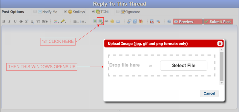

Side question: I see you use cloudinary - when you post images, do you convert them from pdf, if yes, do you use cloudinary to convert? Or do you just always save a .jpg?

RE: Cantilever RC Beam / Transfer Beam / Offset Column
Quote (RF)
No Cloudinary for me. Here's the patented KootK system:
1) Get the image up on your screen any old way. Usually PDF for me.
2) Use the native windows snip tool to snag what you want.
3) Save the snip someplace as jpg.
4) Use the upload image tool here, three left of the quote button.
It's pretty fast and it solves that issue folks were having where pics would be three screens wide.
A picture worth a 1000 words...this...
Wow, for some reason I kept trying to use the "picture" button to the left of the "upload image"... Thanks to both of you.

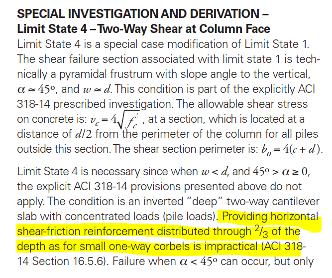

Quote (Kootk)
If you have the latest CRSI on pile caps, they propose an equation there for Vc taken on steep angles. I've been starting to use that for some things and it would be applicable for some versions of this.
This was a good reference. It seems to address my situation. Basically they give an allowable shear value that increases from your typical allowable shear a 'd' from the column face to a large maximum value when the faces align.
They do mention using shear friction reinforcement similar to a corbel but say that it is not practical.
Quote (RFreund)
Can you reference a page or section number for that? I'm interested to check that out myself as it sounds contradictory to my own thinking.
Sure thing:
Page 5-3 See excerpt below:
This is interesting:
The deep beam provisions of ACI say that your shear capacity is:
V.cn = 10*sqrt(f'c)b.w*d
Which is what CRSI uses as a maximum for the pile cap design. Meaning they increase the typical one-way slab shear strength based off how close your column and cap are up to a max of 10*sqrt(f'c). So if I am using grade beams it would seem that the allowable shear would be V.cn = 10*sqrt(f'c)b.w*d so long as your tension bars are anchored (i.e. top bars in my case are developed) and your cantilever distance is less than 2*Lc < 4*h.
Seem reasonable?
I still may just use the corbel/bracket reinforcement and be done with it...

Quote (RF)
Seem reasonable?
I interpret that as a "not to exceed" limit rather than a proposed shear capacity.
My latest copy says the same, so you either do non-linear FEM or STM. I would think STM is much easier.
But you still need to develop the steel past the anchor point (see R11.7.1).
Also for RFreund, ACI says that the shear should be less than or equal to 10*sqrt(f'c)b.w*d . It does not say that is the shear capacity! (11.7.3)
