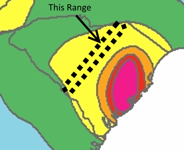

Friendly advice:
You can do more investigation, but if you have to go with the information you have, you must assume it is correct. It says you have potentially treacherous soils. The structure is expensive, sensitive, and highly visible. You have good material available at 20 feet. Give it a highly reliable foundation. Don't mess with numbers until they lull you into doing otherwise.
RE: Rectangular Foundation - Zone of Influence
Quote (geojosh84)
I am in the upper coastal plain near the fall line east of the piedmont in SC...
Refer back to BigH's comment. You are in, or on the very edge of a moderate seismic zone (USGS 16% to 32% g).
www.SlideRuleEra.net idea
www.VacuumTubeEra.net r2d2
aeoliantexan,thanks for the advice. the last thing I want is a monument to my name a mile down the road in my home city. if the client doesn't like it then he can get another recommendation from another engineer.
slideruleera, yeah so I am taking this as an additional reason for deep foundations since the site is set up for potential liquefaction.
