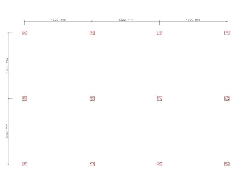

Anyone can suggest for the below column spacing which type of RCC slab will be suitable/economical (two way slab or one-way slab) however there is no architectural restrictions for beams??
And second question is that if I go with one way slab the beam will be in X or Y direction or if I go with tow way slab then the beam will in X and Y both direction (Column to Column), my understanding is correct ??

If it's lightly loaded, I like two way flat plate. Cheap formeork.
It it's heavy industial, I like beams in the N-S direction. If there's limited headroom and a bunch of mechanical that needs to trace around underneath, two way flat slab with drop panels may be attractive.
