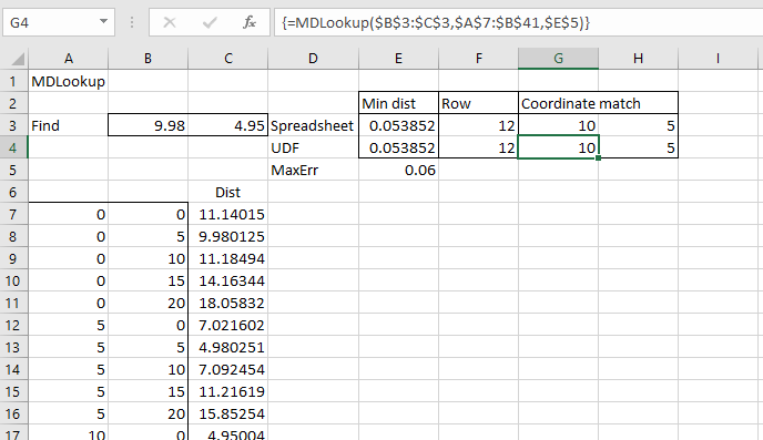

RE: Approx. Matches for VLOOKUP Function
Pete's method works well for a lookup on a single column with stepped data, but unless I'm missing something it won't work with 2D (or multi-dimensional) lookups, and if the data is continuous there is a possibility that the round-off will take the nearest match into a different band, resulting in the wrong match.
A reasonably simple way to do a 2D lookup on the spreadsheet is to calculate the distance from the lookup point to each value and find the minimum. You can then use Match to find the row with the exact match, and index to return the values.
A fairly simple UDF will do the job without needing to generate the distances on the spreadsheet, and will work with any number of columns. I have attached a spreadsheet showing both options:
The UDF also has an option to enter a maximum error in the lookup, and to return the matching row number, or the matching values.
Hi Doug,
The UDF is a really neat solution. This will help me clean up the data quite nicely.
Thanks for the help.

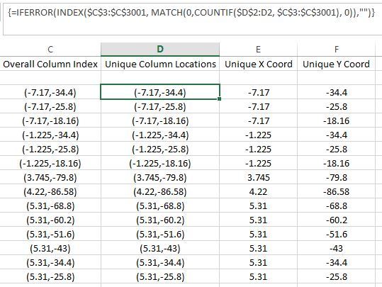

Hi Doug and everyone else,
Coming at it from a slightly different angle...
I have written a macro to gather every single column location on every level (pasted under each other from lowest basement to highest level) in the column "Overall Column Index".
Then I've got the formula as shown to extract out the exact and unique column locations. This is to find the vertically continuous columns and where each column may start/stop.
I'm wondering if I could build the tolerance into this step. I'd like the formula to find if a location is close (eg. 500mm distance) to a location beneath it, return the 'matched' location that occur first in Column C.
Then as we move up the building, slightly misaligned columns will 'shift' back into a common coordinate.
