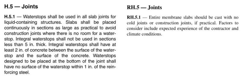

I assume you include a waterstop across the joints correct?
Also - per ACI 350, a couple of snippets:
RE: Concrete Water Retaining Reservoir - Pour Sequence
My approach would be to insist on casting a slab of that size in one go. Not large in plan, and not an excessive volume of concrete for any substantial contractor to handle. Minimising joints is my philosophy. As to shrinkage cracking, casting in strips helps in one direction, but makes things worse in the other.
