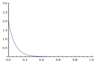

Hi all I have found the solution elsewhere. The motor is a PM linear motor yes.
The equation is this:
Where k is equal to 2583.3 (derived from the mass, back emf, and coil resistance)
m is equal to 200kg (the mass of the unit)
And v0 is equal to 2 (initial velocity)
Graphing this shows the ideal braking curve. Y axis being velocity in m/s and X axis being time in seconds
