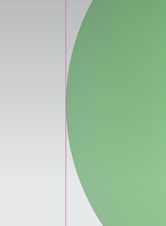

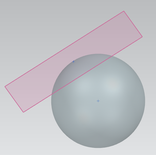

Hi to all,
I need to extract the contact point between a sphere and a plane. I don´t know what command use for that.
Thanks in advance,
Airin
NX Designer
RE: Contact point between a plane and a sphere
Try to project the sphere center point orthogonally (perpendicular, along the normal vector) onto the plane. This point will be the contact point that you needed.
Thanks Lockdain.
Now you already say it seems obvious!! But I was blocked.
Thanks again!
