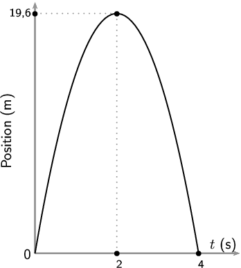

As ever a diagram or sketch would help but my reading of your query is that, to put it simply, you have a metal version of say a jug of cream which you are pouring into a mould / teacup if you follow the analogy.
Thus you have a small amount of horizontal velocity and vertical velocity starts at zero then accelerates due to gravity. That is unaffected by density.
Thus your curve become a parabola, not a fixed diameter.
You can plot this quite easily if you just use simple equations with small time steps
distance L = Velocity C x time t
For a graph X axis, V is fixed
For the Y axis V1 = V0 + Acceleration x t
Each time step you then substitute V1 back as V0.
See this http://schoolbag.info/physics/ap_physics/6.html and go down to example 21
I think you mean something like the graph below, starting at the top???
