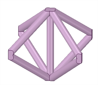

In continuation of thread799-390004: Help meshing a complex part, I have the same geometry but with a vertical extension this time. I would appreciate community's help in achieving all Hexa mesh of this new part. The problem I'm facing is to partition it in appropriate regions to get all Hexa mesh.
This is the new part - https://www.dropbox.com/s/5a5nn4i3jx7m5qr/Part2.sa...
This is the mesh I got so far from the new part by following the previous partitioning scheme (green = structured = Hexa mesh). When trying to partition cell by defining cutting plane, the vertical part also get cut (see Red box). And its not possible to cut partition between the vertical part and the main cylinder (see black circle.

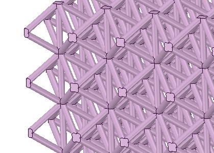

@TsurG, The resulting hierarchical structure will look like this -
The contact among the members are indeed complex (especially in the connection region), hence beams cannot be used. Different approaches have been tried in the previous thread, and meshing the repeating part in all Hex found to the best solution.

First, it would be easier to understand with a figure of a unit cell.
I'm still trying to understand your decision not to use beams. I couldn't find the thread you referred to.
As far as my understanding goes, the rods are not contacting in the joints - they are connected. Hence, no contact is introduced.
Else, there are huge deformations that deform the structure that much so rods will touch their neighbors.

@TsurG, the structure will be subjected to impact loading, the members at the nodal regions do come into contact at 0.7 strain. Modeling with beam element has been tried but gave unreliable result.

If it is a repeating cell structure, and you are interested in the whole structure response and not necessarily into the rods behavior,
you might want to consider using sub-structure in the form of Abaqus Substructure or defining unique material response in the element level.
Meaning, assuming the structure is homogeneous, you can replace each cell by element with matching behavior.
else, you can use the assumption of continuum mechanics and model it as a bulk.

Below is the picture of the unit cell -

I don't see how that part can be hex meshed in A/CAE.
The next best thing would be, that the connection area is meshed with tets and the straight region with hex. When you partition like that and assign these meshing techniques, then A/CAE should create the Tie constraint automatically.
If you are able to mesh that part in another tool, then you could import the mesh (.inp) and define everything else on the mesh in A/CAE.
