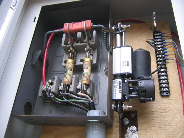

I'm an ME so..... Set the arduino up with a servo to flip a physical switch on some existing, off the shelf hardware. Avoids all the regulatory or code issues too.

1gibson/sparweb - turns out motor operated transfer switches are a real thing. Nice bit of lateral thinking.

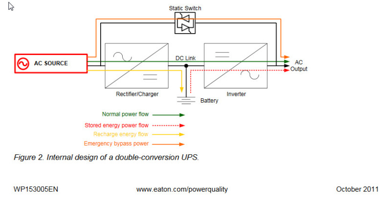

It's still a bit confusing with regard the the power level and the switch point you want a device for. e.g. switching the power mains (implying a generator transfer switch) versus the little PowerSSR Tail Kit for switching a cord and plug connected branch circuit load.
Your last post above infers UPS functionality. e.g. the ability to switch between inverter power and mains power, management of the battery state of charge, etc.
A separate question....in consideration of the nature of the load you want to switch, will be whether "Break before Make" switching by whatever you choose for your overall scheme will have guaranteed, sufficient delay time built in to avoid what could be damaging current surges due to out of phase switching between mains and the inverter output. If switching purely resistive loads, no problem, but if rotating motor or beefy transformer loads are involved, it could be a different story. Reclosers https://en.wikipedia.org/wiki/Recloser in the power distribution grid can "blink" the incoming commercial power in fairly rapid succession trying to clear a momentary short.. If your switch-over scheme is an automatic one, it needs to know what to do in this situation.
Provided the objective is a single branch circuit power level switching, it would appear that a cord and plug connected UPS listed for use in your country would provide the functionality you are looking for and would keep you on the good side of the "People's Republic of Victoria", insurance, etc). The automatic switching, phase synchronization for hand over of the load without interruption or damage when the AC mains are going nuts is part and parcel UPS functionality.
