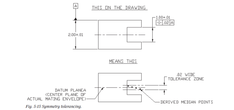

I need to apply a tolerance of form on a piece with similar shape, that the small holes that are patterned aroun the center should be symmetric repect to the vertical axis of symmetric of the big circle, ( which is the most important)

The example does not control symmetry, it controls position of the pattern. If you need symmetry, use a symmetry tolerance.
The part does not have a vertical axis. You will need some feature that defines a plane of symmetry.

This looks like an example from the AMSE standard. From memory ASME does not let use you the symmetry symbol. It uses position instead. Here I think you need position.
You need to be careful as form and position are two different things. Example: The round plate may need a roundness tolerance or cylindricity tolerance especially if you are using the ISO standards and not ASME.. This is form control. (the shape of the item). Positional tolerance controls the position of an item, or hole pattern etc.
The example shown has 2 positional tolerances on the same pattern of holes.
It shows that the pattern of holes needs to be within the dia of 0,5mm to itself but also the holes need to be square to the face you are drilling into within this tolerance. The positional tolerance applies through the thickness of the part. There is also another larger tolerance. This controls the hole pattern relative to the centre of the plate. There is more allowance here. This suggests there is clearance to the OD of this plate to the mating ID of the other part, or for some reason its less important to control the pattern to the centre of the plate than the hole pattern to itself.
If I did a similar example I would datum the face you are drilling into as datum A. Put form contol on it. IE flatness 0,1mm or similar. Remember form control has no datums in the tolerance control frame. Put the centre of the plate as datum B. Control the roundness if the plate is thin or cylindricity if thick. Put squareness tol on the OD to datum A with dia symbol in it. (this controls datum B to A)Position holes to A/B as the example ish.

Symmetry has been back for a long time. It was eliminated from only one version before being reinstated in the next. I recall it was out of the 1982 version , but back in 1994 version.

LCform, you wrote that you "also needed the middle circle be symmetric with respect to the axes." But here's the real issue:
How do you find the axis of that circle? That is what sets concentricity and symmetry apart from the position symbol.
Do you really want to find the median point of every opposing element of the circle? Or would the axis derived from the "actual mating envelope" suffice?

LCform,
I believe I understand the symmetry specification. I don't understand why I would use it. Symmetry should be a refinement of a profile tolerance. Imagine that I apply a 0.1 profile tolerance all around the figure you attached. The symmetry applies a control more accurate than my profile. But why?
Concentricity makes sense if you have a cylindrical datum feature, as opposed to a merely round datum feature. I cannot recall ever doing this, but I do not draw very many shafts.
In either case, you can use positional tolerances.
