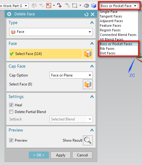

RE: How to present gear teeth in NX 2D-draft
With the correct selection it will automatically select all faces connected to the face you select.
I came up with another improvement: It could be wiser to have the "simplified" revolved form with all details first finished, and at this point use "Extract geometry" and cut the tooth 3D-geometry in the extracted body in different layer. This way the dimensioning in 2D-drawing can be done reliably with the simplified model, and if necessary the extra layer with exact tooth geometry can be called visible in certain drawing views or at higher assembly level. Also this method does not require manual selection of tooth gaps.
