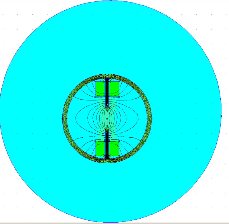

RE: Coil wire - maximum current?
Since you posted the geometry, I thought it would be worth clarifying: is the outer circle a physical core or just a mathematical means to establish a boundary condition that simulates an unbounded geometry?
(2B)+(2B)' ?
The outer circle is indeed a core. It is there to provide a 'return path' for the magnetic field, and to serve somewhat as a shield to isolate the setup of fields of neighbouring setups. There will be in fact 4 of these setups in a square-like configuration.
I am using a boundary but it is outside of this picture.
See pictures below that show the boundary, one with the circular core, and the other with the core 'removed'
ok thanks. If I had read your post carefully I would have figured it out but thanks again for clarifying.
(2B)+(2B)' ?

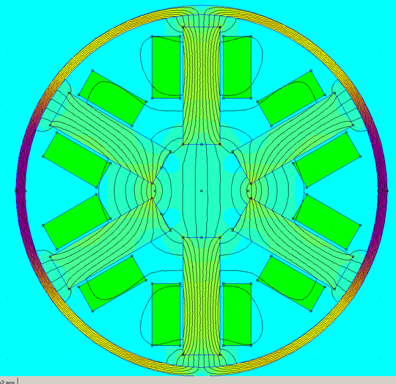

@electricpete:
>I guess if this is an axisymmetric model, then the outer mu metal is spherical?
-- No, it is a planar model. The graphics above represent top views.
Probably, the top or the bottom will be open, allowing for some airflow.
I have limited space available. The diameter of the shield can be no larger than 60 mm (2.36 inch).
Furthermore, while the model shows only a single coilpair, in reality there will be 3 coilpairs, positioned at an angle of 120°.
Much like the coils of the stator of an asynchronous elektromotor.
See picture.
This very much limits the size of the coils. It is possible that I can't reach 50 mT, also because I have to limit the max current due to the high temperature.
That's why I am considering a different design. See my next post.

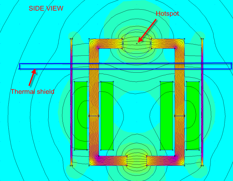

@electricpete:
This is my new design.
Note that this is a side view (planar model). So the coil axes are vertical.
With this design, I can make the coils bigger and also move them away from the 'hotspot' to a 'colder' place.
I could even incorporate some kind of thermal shield between the hotspot and the coils.
Forced air cooling on the coils is perhaps also an option.

Why is there an air gap outside the oven?
@Compositepro:
Which air gap do you mean? The one inside the coil, or the one below? Or the one above?
I mean the bottom one.
That was a good question! with big gaps in the magnetic circuit, you are not taking advantage of high permeability of mu metal.
And you can both eliminate the 'back' air gap and perhaps add coil winding there as well, that would reduce the winding depth on all coils and help with heat dissipation. I have seen coils wound on thin Ti spools (with large, thin end flanges) to help with cooling.
The gap below is due to the fact that there will be 3 coilpairs at an angle of 120°. The picture before the last one is a top view and this shows the principle.
So, at the bottom in the center, 6 cores will come together. I could probably reduce the size of the gap. If I use laminated mu metal, I could make the cores more or less V-shaped where they come together to reduce the gap.
