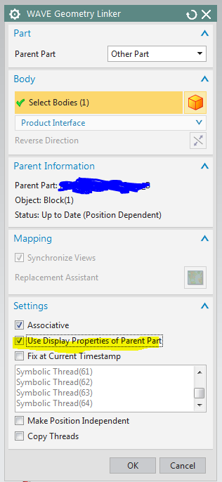

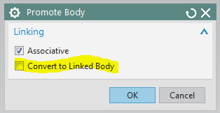

We do hole and slot milling operations for connectors on off the shelf electronic boxes, our current method is to define these operations in the box part directly which we then save as a new part, we then specify the box manufacturers article number as the part material for purchasing.
We now want to separate the machining from the actual box part, thus I am investigating modeling methods to accomplish this which brings me to promote body which is something I have not used much before.
Promote body seems promising except that the promoted body loses any face colors specified on the parent body, is there some setting for this or is this a case of working as intended for some reason?
Part with two bodies and specified face colors
The two bodies are promoted one level and promptly loses any face colors.

Hi, @petulf
If I caught your idea the right way - you need to promote a body from the component level to the assembly level in order to separate the machining from a design part. If we look deeper into the Promote Body mechanism, we will find that it works nearly the same, as WAVE-copy is, i could say more - if you double click on the promoted feature in the Part Navigator - you would be able to change it to the WAVE-link. After that you would be able to change the resulted WAVE-link option to inherit display options from the parent. I'd rather choose WAVE-links instead of Promote Body, they are nearly the same- Promote creates an associative copy and hides the original object.

RE: Promote Body Colors
Lockdain: Thanks, yes wave will accomplish the same task with more flexibility but at the cost of complexity. What I am after here is promote bodys simplicity with regards to the handling of the promoted body, as it abstracts away any need to manage duplicate bodies between the stock part and the machining part (visibility).

@petulf
If it is about the visibility - you're able to use the Hide Original option while in WAVE Geometry Linker.
No simply hiding the source box part would not be suitable as you easily get into a situation where both solids are shown in the larger assembly context (eg show / hide all bodies). Removing the stock box part from the model reference set and adding it to a new one would probably be the way to go with wave links.
I would say this is very close to a bug. ( - You never know how Siemens will be reasoning smile
If you go Preferences - Modeling, there is a setting for
"Display properties for new geometry : - For extracted and linked geometry : Parent object or Part default.
The default is Parent Object , the question is whether Siemens will treat a Promoted Body as "Linked or Extracted", or if it's "Promoted"...
Since promote uses a different mechanism than wave links, my guess is that GTAC will say it is "working as designed".
www.nxjournaling.com
Yes one man's bug is another man's feature, but I will send in a problem report to gtac and see what they say.
