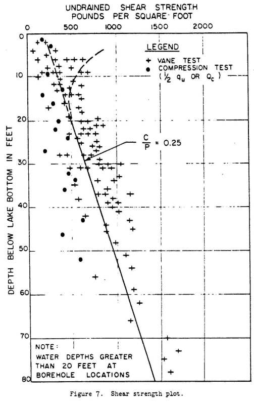

I have a firm sandy clay, ive said it has a Cu of 40kn/m2, would it have an angle of internal friction value as well, or in undrained conditions it only has shear strength?
I have no lab data just a description to try to model off.

My take - for a deposit with depth, one does not expect the undrained shear strength in the deposit to be uniformly the same throughout the depth of the deposit. Su/pv' ~ 0.25, say (with a range). Hence at 5 ft depth, assuming no desiccated crust, you have an undrained shear strength Su5. At 15 ft depth you have Su15. I do not see why these initial undrained strengths would be the same. There is going to be an increase with depth. So, if one is to model you have a choice - having a "uniform" Su for a layer (as many use a uniform Eo for the deformation modulus) or to have an increasing Su with depth (as there is an increasing Eo). As the Su, phi is a model, I typically use phi=0 - but will develop several substrata with different Su values - or I would think that you could use a small phiu value of 5 or so degrees if you start with the initial Su at the surface of the layer. Tradition is phi=0.

I would think so - remember you need Su at the surface and then the increase of Su with depth. One such graph is below - Matich and Brownbridge Soil Investigation for Rainy Lake Causeway, Highway Research Record, 1964. Might want to be a bit more conservative than 0.25
