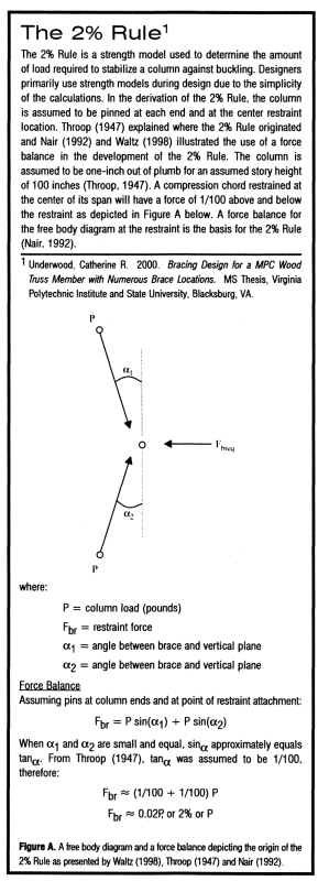

You could go with the "2% Rule" (see below), but I would increase the value to at least 5% since timber piling are not as uniformly shaped or accurately placed as typical columns.

In the past, design of pile bracing has be based on experience and engineering judgement, not code requirements.

I concur, to provide a brace point for the piles I'd design for something better than 2% of axial load (5% sounds good).

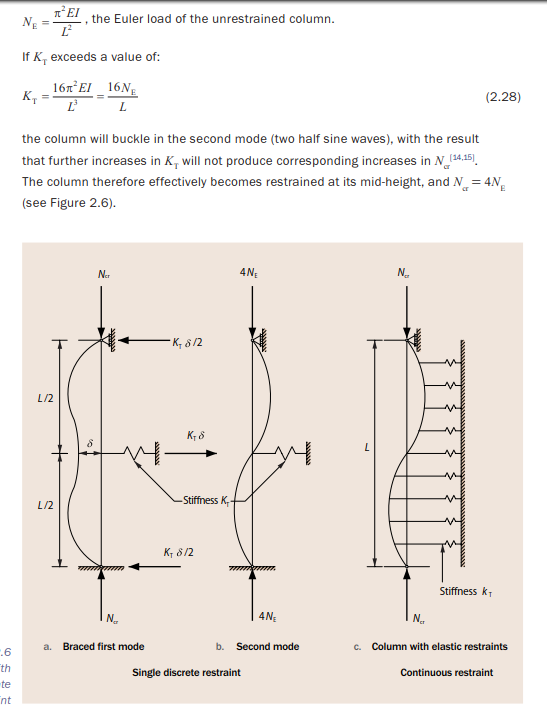

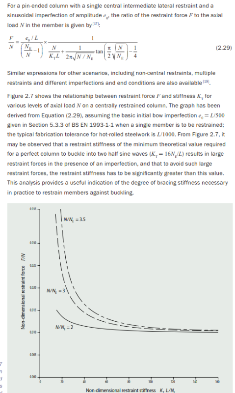

There are both strength and stiffness requirement for bracing per appendix 6 "STABILITY BRACING FOR COLUMNS AND BEAMS" in AISC 360.
