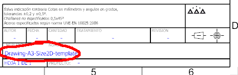

Hello,
I have made a template for drawings including a logo image in the title block. The problem is that when I créate a second sheet, it automaticaly relink the image from <!IMAGE=Ref1*0> to <!IMAGE=Ref2*0> so the image no longer appears (I have to manually rewrite the link).
I have a text linked to the filename <W@$SH_PART_NAME> but when I créate a new drawing the text doesn't update till I close/open the file or créate a new sheet.
Any advise for solving these problems? Thank you in advance.

I attach two pictures.
One has the name ok but the logo image are not shown, it happens again sometimes.
The other picture shows the logo, but the name of the file is still wrong (still showing template name instead of file name, it is solved after closing and opening again the file).
