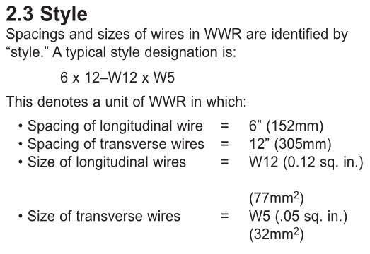

Hello
I need some clarification on this;
In AC 150/5340-30G; Figure 126(FAA), Standard Details for Taxiway Hold and Guidance Sign (Page 254).
What does the Wire Mesh 6” x 6”[15cm x 15cm] No.6 means? I know the 6” x 6” is the spacing of the wires but what I need to understand is the No.6.
Erasa
RE: WIRE MESH FOR CONCRETE WORKS

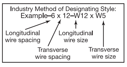

I don't have a copy of the document you reference, but the following is the typical definition of the WWR style/nomenclature:
So for your case "6x6-W6xW6" would be plain (undeformed) wires at 6" long't and trans spacing, with each wire of cross sectional area of 0.060 in2
The "6" is the gauge (size) of the wire. It is usually the same in both directions but can be different as noted by Ingenuity
