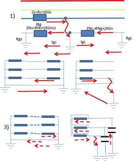

1.Star connected earthed neutral Source to Star connected earthed neutral load? Say if a L-G fault occurs between the source and load, How does the fault current gets distributed? To the source side neutral or load side neutral?
2.Star- Star Transformer. Neutral earthed on both the primary and secondary. say If a L-G fault occurs on secondary side, does the fault current flow in to the primary side neutral too? How does the fault current reflected in the primary?
3. Star- Delta Transformer. Neutral earthed on Star side. say If a L-G fault occurs on Delta side, does the fault current flow in to the star side neutral? How does the fault current reflected in the star side?

What do you have so far? A tip: current can't flow in one transformer winding unless it flows in the corresponding winding on the other side of the transformer.
RE: Fault Current Distribution
1)The current will flow through the faulted phase conductor from the source up to the fault point . Here it will split part to the source grounding grid and part to the load grounding grid.
The current part from load grounding grid will flow through to the source through Ground and through neutral conductor.
2) The primary current will rise by induction phenomenon in order to preserve Ip*wp=Is*ws. No galvanic connection.
3) The other two phase secondary windings are capacitive loaded only and then
two corresponding phase primary windings are loaded , the neutral and the grounding will carry part of current. However, these currents are negligible.
