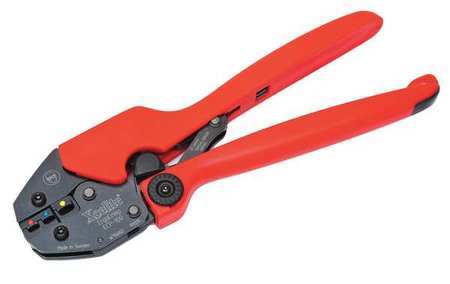

I'm looking for a low force crimping tool for standard insulated barrel terminals. I just finished part one of a job (3 more to do) that required a cr@p load of 10AWG crimps. My hands hurt enough to bother my getting to sleep.
Does anyone know of a hand crimper that takes less force than the typical ones out there. I'd really like one that maybe takes a couple of squeezes instead of needing both hand and literally a knee to push against to put a pro crimp onto 10AWG. Hydraulic would be fine too but I bet those only start at 8AWG or larger. Or one with looong handles for more leverage. Or multiple compound advantage.. Something, anything better than this POS AMP crimper.

I decided to go with the same old usual style only with much larger longer handles for more advantage. I started looking for a crimper that would do 8AWG figuring those would have to have more advantage than normal 18/12/10 crimpers. I did find some but they tended to be 10/8 and I almost did get those except I found enough 18/12/10 with long handles and time was crowding me 5:30AM rolled up so I went with these:
xcelite-ratcheting-crimper
Which has 12 inch handles.
If they don't do it for me I will be getting the Greenlee and using the Panduit dies. Nice tip there Lionel!

I didn't mention it but the Panduit CT1701 does down to #4 uninsulated lugs and it's the same frame as the CT-1550. It pretty much does require you to crimp on a bench when using it.
The flat side on the top of the crimper you pictures looks like it could be put on a bench to make crimping easier.
You should be able to hold those crimpers in your hand with bottom handle in your palm and when you're ready to apply the crimp force you just put the end of the other handle your fingers are holding against a solid surface and push.

That style looks very like the Pressmaster types in the UK. They're popular with our techs because they are definitely easier to use than the conventional T&B / Amphenol style.
