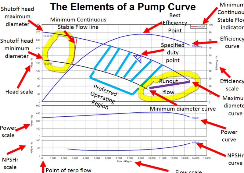

It seems that pump run above or bellow the following graph region may cause the vibration problems.
