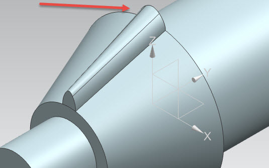

I wanted to create a sweep from an arc and paths, the finished CAD neutral file is attached. And the file I created is also attached.
But I am not able to understand why the shape seem to be different. Please suggest some settings in Swept tool or any other method so that I can match it….Thanks a lot.

In the swept feature there is an option to do the scaling Uniform or Lateral, this is when you use 2 guide strings to control the scaling of the section it moves along. Uniform scales uniformly in the section plane, lateral scales only in the direction between the guide strings , the perpendicular direction is constant.
Try edit the sweep, set the scaling to lateral.

Thanks Toost for the reply I tried it but result is not up to mark......See the image.
Any suggestion please.

But what do we know about the sweep-options that were used in that other system ? ( Catia ?)
If i look at the "original file" , it seems that the "blend" face on the top has a constant size along the sweep. This is either an option in that other system, or it indicates that the blend is a separate operation.

Can you use two guides? Is the pitch parallel to the cone? Use one swept guide curve at the center line of the shaft. Then use another guide line that maybe or maybe not parallel to the cone feature? Sketched on the datum coordinate system. On a bevel gear the root angle is not the same as the pitch angle. I added an image for you. I do not know if this is what you are after. Thanks

Not to muddy the waters, but if it were me, first I'd take the "original file" and examine the "blend" face which Toost pointed out (Info -> Object -> Face) and find out if the blend face is a B-SURFACE or not. If a B-SURFACE, I'd try Optimize Face under the Synchronous Modeling tools to see if I could get a blend face out of the B-SURFACE. Chances are it might be a conical blend, which can be dealt with by either an Edge or Face Blend (if you Sweep with a sharp edge).
If that didn't work, then SDETERS is probably on the right track - the guide more than likely needs to be angled. Maybe Sweep it past the planar surfaces and use Trim Body to cut it down to proper size. Nothing against the full Sweep, I just prefer blending with features rather than putting them in my sections (most of the time). Six of one, half dozen of the other.

Seeing the video, it looks like a "NX variational sweep", the sketch has a chord dimension (0.79) which dictates what i mentioned above.- the constant size/ choord. The Variational sweep will can do this.
Note that this option, the constant choord, can be done using the Aesthetic face blend, you can do the sweep w a sharp edge and then apply a blend separately.

The difference between a "Sweep" and a "variational sweep" in NX is that The Sweep feature uses the curves from the sketch, ( It ignores the dimensions/ constraints) the shape of these curves will be interpolated during the sweep. The guides and the options selected dictate the resulting shape. In a Variational sweep, it's the dimensions and constraints in the sketch that rules, all along the sweep.
Thereby the difference on the chord length of the "blend". In the variational sweep , the dimension 0.79 will dictate this all along.
