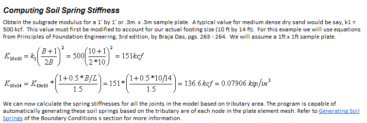

What I'm really interested in is this general equation from Braja Das's Principles of Foundation Engineering for adjusting the spring stiffness used in an analysis based on the size of the foundation:
Right now, I'm really most interested in how to convert this equation into something that works for a circular or octagonal foundation.

You will find some equivalency between square and round footings in various texts - I've seen in Richard Hall and Woods. The following is from a Ph.D. thesis:
The circular footing is changed to an equivalent square footing with the size of B = R * π^0.5 .
