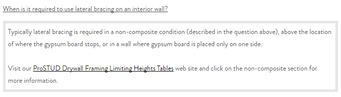

Well yeah, that's pretty much all that I do unless the studs continue substantially higher than the sheathing. See the exerpt below from Clark Dietrich's website.

we have a note for interior partition conditions which states that if the wall has sheathing, gyp. etc. each side the bracing is not required.

For interior, non gravity load bearing applications of normal proportions, I don't see the need as the sheetrock should provide proper restraint. I will always show it on interior (or exterior) gravity load bearing studs as the sheetrock may be removed at some point causing instability.
