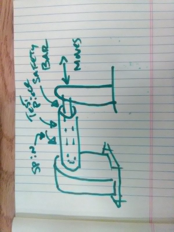

Ring containment is the sort of thing I was thinking too. You could also invert that and have a safety bar that extended from the free end to the driven end. Then the really dangerous sort of thing (instead of merely real expensive) like the test piece flying off and killing someone is made not inconceivable, but the result of many unlikely failures. See my sketch for clarification.

The test piece will have a flange on one end that will be attached to a u-joint. I see the u-joint as a pivot point to simplify calculations. We will be applying the 20 Ton force in the middle of a 12' shaft, we want to test for catastrophic failure. The test piece will rotate but be mounted on both ends of the shaft (I realize I had drawn my sketch without one end). I never thought of the safety for driveshaft and PTO, I'll take a look at that. We had planned to have two slings, one on either half of the shaft.
